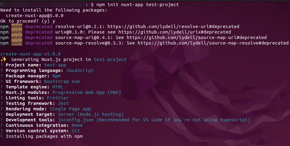

  2. Next, create a new NuxtJS project. You can use the NuxtJS CLI (Command-Line Interface) by running the following command:
    npx create-nuxt-app <project-name>
    This creates a new NuxtJS project in the current directory and prompts you to answer a few questions about your project, such as the project name, the package manager to use, and the project type. (See sample details below for a test project)
